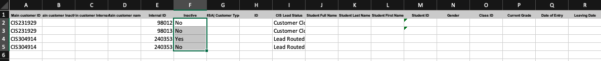

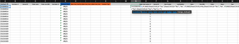

Hi,
Am trying to match the client ID from a range where the client ID is associated to one or more sub-customers. From the matched ID, we need to return the YES or NO status depending on the sub-customers.
Vlookup ID, IF ID Match, look through sub-customer column
If sub-customer = Yes and sub-customer = Yes return YES
If sub-customer = No and sub-customer = Yes return NO
If sub-customer = No and sub-customer = No return NO
But am not sure how to use the formula as there was an error "#NAME".
This was what I had used and it had an error - =VLOOKUP(A2,IF(AND(Sheet1!A:R,6="Yes",Sheet1!A:R,6="No"),"No", IF(AND(Sheet1!A:R,6=No,Sheet1!A:R,6="No"),"No", IF(AND(Sheet1!A:R,6="Yes",Sheet1!A:R,6="Yes"),"Yes"))),"")
Do share on how it should be done. Thank you.

Hello,
Welcome to the ExcelDemy forum. According to your post, you wish to get the correct formula to match the client ID from a range where the client ID is associated with one or more sub-customers using VLOOKUP, IF, and AND Statements. Please follow the below formula to execute this process.
=IF(AND(VLOOKUP(A2,Sheet1!A:B,2,FALSE)="Yes",VLOOKUP(A2,Sheet1!A:B,2,FALSE)="Yes"),"Yes",IF(AND(VLOOKUP(A2,Sheet1!A:B,2,FALSE)="No",VLOOKUP(A2,Sheet1!A:B,2,FALSE)="Yes"),"No",IF(AND(VLOOKUP(A2,Sheet1!A:B,2,FALSE)="No",VLOOKUP(A2,Sheet1!A:B,2,FALSE)="No"),"No","")))
